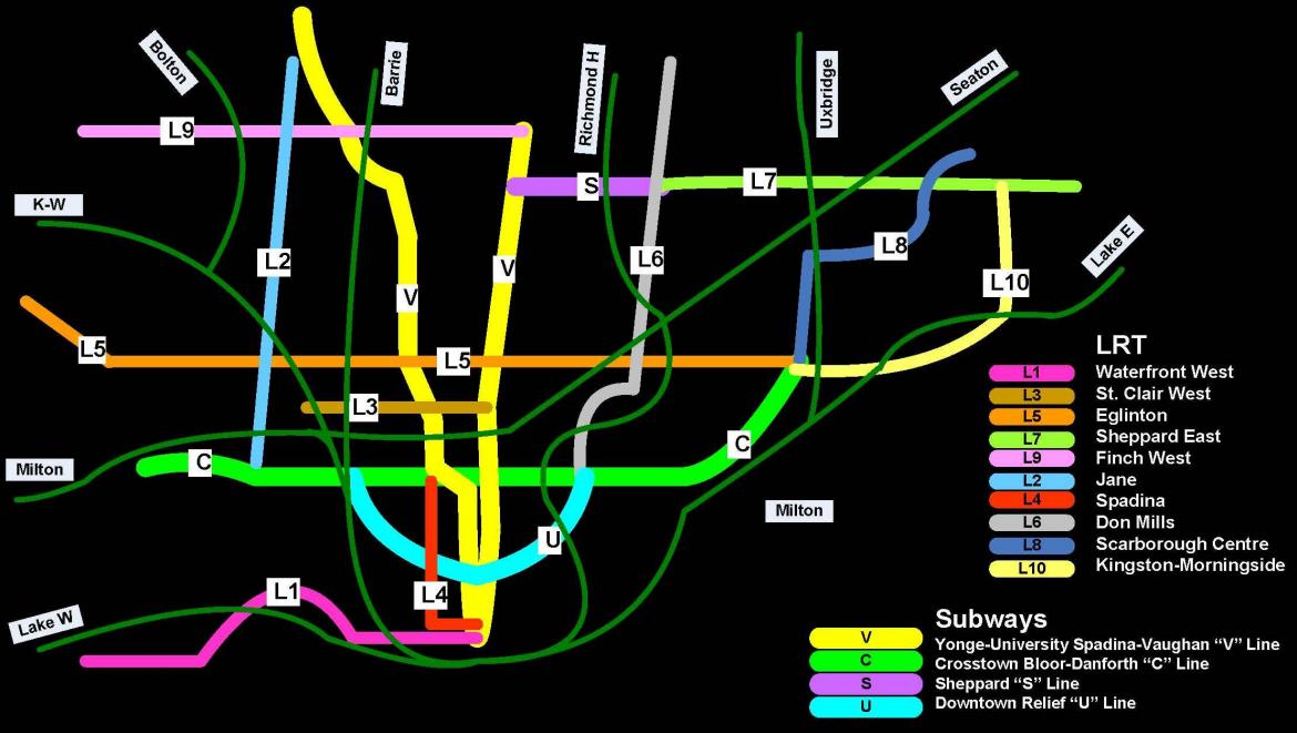

Using TigerMasters cue, I came up with this system map to show all future lines (I included St. Clair and Spadina as LRT since I believe they will be re-branded at some point in time). Each line has different colours (some shades are close, but are geographically separated to avoid confusion. (No debates on the location of the DRL - there is another location for those comments). My graphic abilities are very limited, so I am sure any one else could make major improvements to this.
A few things I noted
1) Many colours in itself almost adds to the complexity - I need sunglasses.
2) With all these lines, I doubt that all the station names would ever fit onto one map. Maybe this overall map should contain only the interchange stations. The individual line maps would need to be looked at to find the remaining stations.
3) If we have an integrated system, then all GO and TTC should be identified on one map. (If they remain as is today, the GO lines should be a much fainter colour). If this is done, it may be better to have the GO lines labelled G1, G2, G3, etc. The LRT lines would be L1, L2, L3, etc. The subways would become S1, S2, S3, S4 - or we could use M for metro instead of S for subway. Heck, that could be a source of revenue - we pit Subway Restaurants against Metro Foods and the highest bidder gets their name.
I disagree. As you can see from this map I made, fitting more lines onto the map while maintaing simplicity is very easy. Also all the names can fit on the map, but they should ideally be put somewhere else.
A few things about the map:
-Its not to scale
-Its not related to my sign design project. Thats why it doesn't use the same naming system as my signs
-The map is incomplete. That is why there is no Jane LRT. There are also some names floating where the Jane LRT would be.
-If you want to view the full sized image, right click on it, select copy image URL, and paste the link into your browsers address bar.
