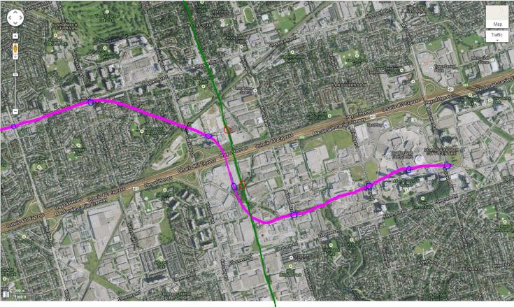

A) If Scaborough RT is truly being abandoned, we can use its current Elevated ROW for a sheppard subway connection to Scarborough Town Centre
B) So that means we only need to tunnel up to around Kennedy and then the rest we Elevate (Including a massive span over the 401)
This is an elevated that would affect no residential properties and wouldn't have much objections because the ROW is elevated already.
I've also put in 2 potential GO Station interchange areas. Which one should be chosen would be decided based on detail study...probably the north option.
Chances of this happening? Probably slim. But gotta think outside the box

You can't use the existing elevated structure. It needs to be strengthened for LRTs as it is, nevermind subway cars which are heavier and exert more forces on it.
And an elevated structure over the 401? How many buildings are you planning on tearing down to make enough room for the ramp?
I like this. Part of the opposition to sheppard is that the road is bare. Your alignment goes through a much denser area.
I agree that the elevated structure would need to be completely rehabbed or replaced.
But why do you say the subway cars are heavier than the new LRT cars? The new subway cars are about 23 metres long and weigh about 34 tonnes. The Flexity Freedom car being used on the Sheppard East LRT are 30 metres long and weigh 48 tonnes. So the LRT cars are 30% longer than a subway car, but 40% heavier. Now the new LRT cars have 3 bogies, compared to 2 on the subway cars ... so the weight per bogie is certainly similar ... and perhaps the LRT vehicles are slight lighter that way ... but the difference is marginal.
150 meter trains vs 90 meter trains.
The loading on the elevated structure depends on how much weight exists between the pylon supports. As long as the supports are less than 90m apart (which I assmue they are), then they probably have the same effect on the structure.
Train length will make a difference to the weight on the pylon, depending on the length of the spans.. When people on this forum say "subway" they don't think of 2-car long trains.

I really like your idea. If we were to utilize the elevated guideway as ROW for Sheppard subway, it'd be possible for that line to replicate what the Scarborough LRT was going to do through eastern Scarborough. Here's a quick illustration of how we could merge the two plans:
Per this scheme the Sheppard East LRT really isn't needed and BRT could suffice. And with elevation primarily used south of Sheppard and northeast of Tapscott, construction costs would be significantly less expensive.
The subway won't work without reaching STC. And there will never be enough money to do that.
I say that we bite the bullet and pay the LRT conversion costs and then aim to go right up to Weston Rd in the West. There's the half-assed northern crosstown right there. Just look at the subway as similar to the Eglinton tunnel.
Massive gap right in Agincourt on Sheppard. Arguably the densest part of the corridor in Scarborough. How would they be served?
Using the SRT ROW is useless. The old SRT stations were all but useless. The ones that are useful will become subway stops anyway. And there's no need to take the subway up to Morningside Heights.
