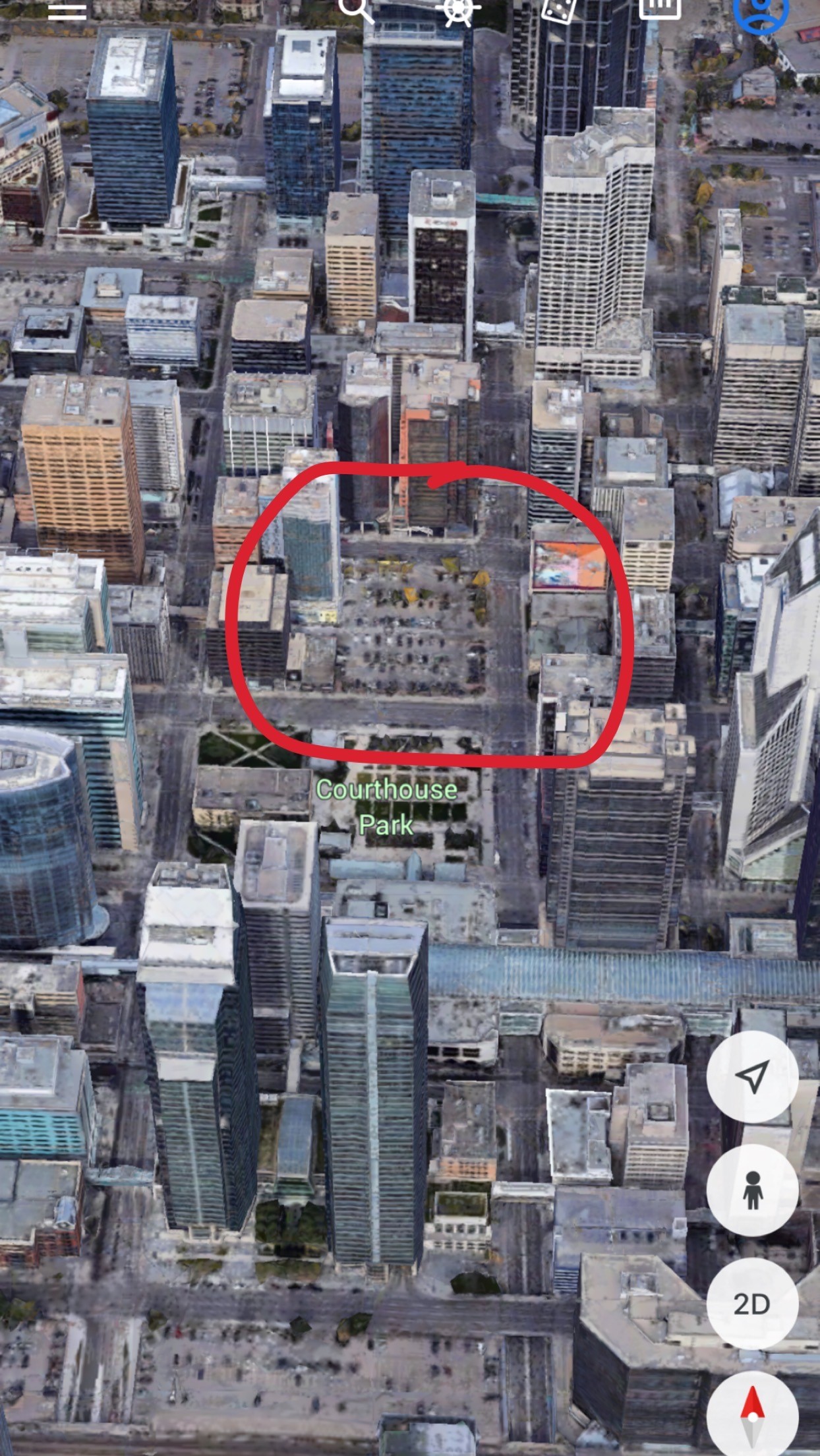

I hope we see a boat load of five/ones pop up if we get a building boom. Time to re-introduce a recent question. Which major project will be the next to break ground? As far as I know there are only a few that were rumored as possibly close, due to permit action etc.. West Village Tower III, Sovereign, and Gallery First and Tenth.
Color me ecstatic if a mix used super tall was next on the list right here:

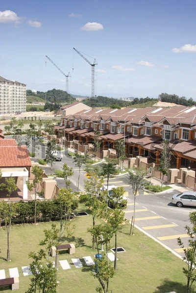

High rise towers wil be popular too but will be no less cookie cutter. Same for suburban houses. Check out these townhomes from KL

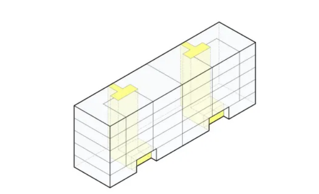

Point Access Blocks are pretty common everywhere outside of North America due to more permissive building codes everywhere else, particularly around elevators and fire stairs. Essentially they are low or mid-rise buildings that have a single stair/elevator to connect the units vs. a common corridor in the middle that are common in 5/1 design here. Here's a diagram:
The rationale goes that point access blocks can look relatively similar to a 5/1, but offers better floorplate efficiency because they don't have that common corridor in the centre to connect 2 or more fire stairs and elevators due to our building codes. It's all incremental stuff but adds up; that extra bit of space goes to the units, and makes 3 bedroom apartments cheaper, with better light and air and generally easier to fit into a building. Buildings are often narrower too as you don't have to fit that common area in the middle. Skinnier buildings mean more space on the ground for other things like gardens and public space.
A little bit higher efficiency means money can be left over for better materials too - although as we have seen this is hardly a guarantee as money isn't the single factor in poor exteriors in Calgary.
There's probably a few good resources out there, but I like this one as quick overview of the benefit and gap with 5/1 design: https://www.larchlab.com/point-access-block-policy-brief/
