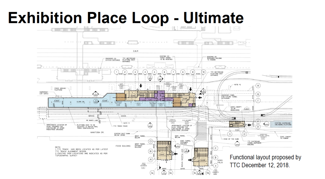

Does the the reverse loop at Exhibition Loop still exist or does the 509 now drop down on an angle and drop riders off going west?? Only showing the angle line going west in these plans. The idea for the Exhibition reverse Loop was to drop riders off like they do today and loop to go west not only to Dufferin Loop, but also west on King St to/from either Long Branch, Park Lawn or Dundas W Station until the Lake Shore Line is built around 2035.
Isn't the rebuilding of the Dufferin Bridge supposed to start in 2022, let alone the other 3 bridges as I have lost track on them??? Once this starts, the Lakeshore Line will be on detour like in the past.
You're talking about this?
Looks like the westbound streetcars would be located north of the Food Building, while the eastbound streetcars would remain where it is now (sort of). This was as of 2018, so with there likely will be changes with the Ontario Line's Exhibition Station.
To the east where the angle westbound track start to angle, that is where the eastbound track was to loop backup to the westbound track that I saw some years ago. This would allow service from the west to loop to go back west. Even the current 509 could still off load like it does today and loop to continue west. It could have been remove now. Having only one elevator per tunnel is not going to cut it and should look at a ramp system.
There is documentation, dated February, 2018, for the Exhibition GO Station. Probably also having to be done all over again because of the Ontario Line.
From link.
It shows the westbound streetcars could shift south to westbound tracks heading to the Dufferin Loop. Also possible reverse loop for eastbound streetcars needing to go back.
