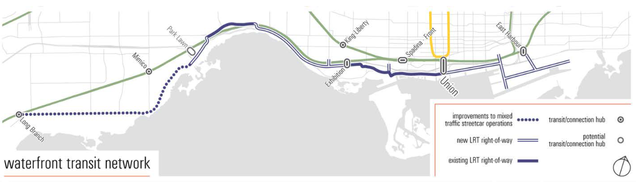

Probably about running a full Queens Quay line instead of having the 509/11 on the east and some sort of Cherry/Port Lands car on the west, with a transfer at Union.
From link, dated 2019.
n April 2019, City Council approved a streetcar loop expansion as the preferred option for the Union-Queens Quay Link and requested staff to commence the preliminary design and engineering stage of the project in 2020.
The Portal study is to be complete within the next 2 months, but the prefer location is west of Yonge. There is about $40-$50 million saving doing this.
A study is to look at taking Phase 2 all the way to Cherry St Loop than stopping at Parliament St as per the original EA plan.

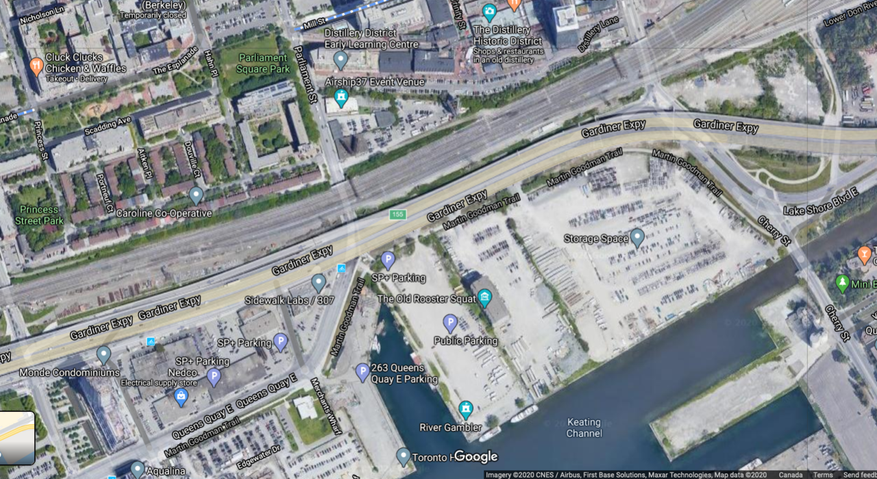

Noticed a mention of a Parliament "lakefill". Went to Google maps (link) and found this...
With the need to extend Queens Quay East to at least Cherry Street, they'll need to fill in a portion of the Parliament Slip. Looks like a building (labelled "The Old Rooster Squat") is in the way, as well. Will the road need to go around it?
^Some background info on that silo:
What's the plan for that entire site (parking, silo and the storage) - is it being redeveloped as part of the LDL/Port Lands project?
That still unknown and no precinct plan yet that I am aware of. There is a vision what QQ is to like and it will the same as the east extension and the west, but at 35 m width. That is why the slip has to be partly fill in, as well at Jarvis.
There is a precinct plan (Keating Channel) dated to 2010:
It foresee partial filling of Parliament Slip and realignment of QQE. This is nothing new. The particulars of the broader plan will change due to the Gardiner.
