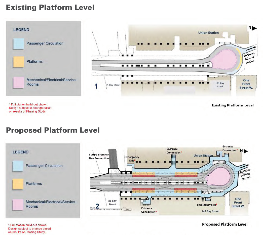

Looking at the materials, interesting to see that they are protecting a future streetcar line on Bremner. I thought that was missing on the last version - though I'm starting to lose track of all these iterations.
Good to see more exits as well - though will we ever see an exit to the SE corner of Bay and Front?

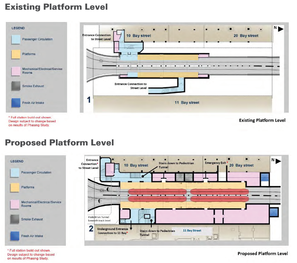

I don't recall seeing a detailed figure of the changes at Queens Quay station before. Are we finally going to see the end of pedestrians walking over the tracks? I'm not quite sure what it's showing at the south end of the two platforms. But the addition of a tunnel under the station, and elevators on both sides, suggests so.
Also, with the extension of Queens Quay station further north, and the Union terminus further south -at what point does it start making sense, just to connect the two with a pedestrian walkway along the east side of the tracks? :)
I don't recall seeing a detailed figure of the changes at Queens Quay station before. Are we finally going to see the end of pedestrians walking over the tracks? I'm not quite sure what it's showing at the east end of the two platforms. But the addition of a tunnel under the station, and elevators on both sides, suggests so.
Passenger circulation is in light blue, there is no light blue across the tracks.
What is shown is stairs leading down to a pedestrian tunnel under the tracks.
So, I agree there will no passenger crossing of the ROW permitted.
Also just to clear up confusion, the platforms are oriented N-S. So there is no east end to the platforms.
The "Bremner" Line Connection is just rough-in, setting aside space, just in case sometime in the 22nd century they decide to add a new line.

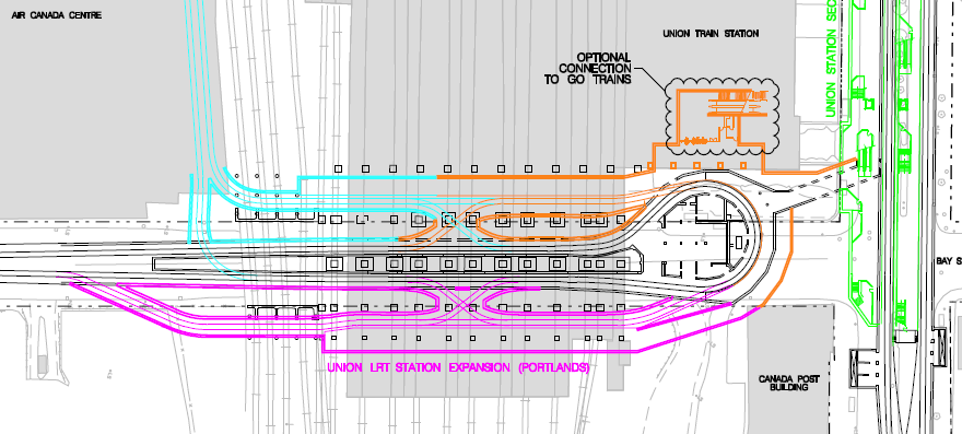

Here's an iteration I archived 12 years ago. The iterative progress here is gawbsmacking.
But isn't there a pedestrian crossing now - or have they gotten rid of it in the last year? It doesn't show blue across at the south(!) end of the current station.
But yeah, seems there won't be in the future?
Indeed. But for some reason, I thought it had vanished in the previous iteration. Maybe this is just more detailed.
