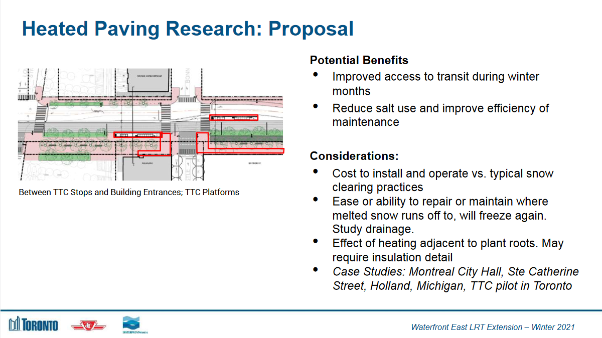

(Also, I wonder if the sidewalks from Union to the Waterfront could be heated/weather protected to make the walk from Union south a little easier during construction)

Have not heard about heated north-south sidewalks and doing QQ sidewalks is not a done deal at this time. Greening N-S roads been in the works a long time and about to happen over the next few years.

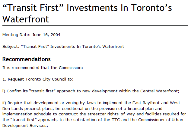

Here's another sad blast from the past. Note the date. This was a couple of years before the release of a till-then-hidden study which stated that the Scarborough RT would fail by 2015 and it should be upgraded to expand its capacity by then to meet future demand for about $360 Million. This was a few years before Ottawa even conceived the Confederation Line.
I can't wait to see Villiers Island get developed and to see the Cherry Street and QQEast LRTs take shape. I can tell that with the planned park at the foot of Leslie St. at the lake and past discussions about transforming The Hearn plant into some kind of Tate Modern branch of the AGO, as well as the restoration of the mouth of the Don and the opening up of development along the Keating Channel as the Gardner is shifted (Hybrid), the Port Lands will become an exciting part of the city. Making it accessible by connecting it to the East Harbour station, Harbourfront, and the Distillery District through light rail is important.
That was and still is Waterfront Toronto position since 2004. Even Mayor Dave Millar wanted to see Transit to be First for the waterfront.
Transit First has been pushed by me and others since 2010 to the point the City of Toronto has stated now it is time to do so, but only talk so far since council calls the shots for funding.

^The TTC is piloting that already? Where?
I'm only aware of their testing heated shelters, not heated sidewalks/platforms, but I could be incorrect about that.
The heated sidewalk only surface at Dec meeting and no location was given for testing. The slide shows the heating only at stops locations, but is to be look for the whole corridor. Cost will be the driving force as to how much gets heating as well if it will happen at all for stops.
Look what is required for GO platforms and where/how will the mechanical buildings be place on the street to do the full or part sidewalk???
