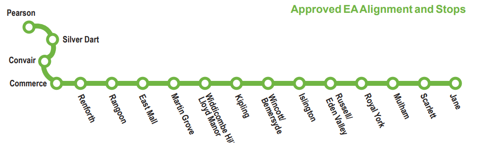

The stop spacing for the more grade-separated lines are a little silly... 3 stops at the airport and then just Kipling and Scarlett. Why would you need a stop between Pearson and Renforth, let alone 3? And the Islington bus is one of the busiest in the system with a weekday ridership of ~18 000, so it would make sense to at least have a stop there.
All these configurations seem a bit strange. I'd just expect Bloor-Danforth spacing (i.e. every arterial), or something speedier since this is nowhere near as dense as Bloor/Danforth. Not double the spacing. And certainly not the strange combination of several closely spaced stops then nothing for a few kilometers, passing over busy bus routes.
My preferred spacing would be:
Pearson -> Renforth Gateway -> Martin Grove -> Kipling -> Islington -> Royal York -> Scarlette -> Jane -> Mount Dennis (9 stops total)
But if you wanted to be extra speedy you could cut out Martin Grove, Islington and Jane (6 stops total), but you would miss out on some good connecting bus routes.

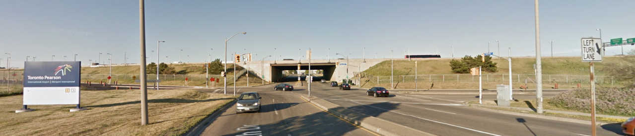

I just want to point out in the EA that even the speediest option, which skips Islington, Jane, and every major cross-road, includes stops here at Silver dart, hedged in by the airport and two highways:
And another one here on Convair, also hedged in by highways and the airport:
So I am seriously questioning the judgement and the options decided by an EA which ignores its own business case and then produces this as the approved option:
If Jane is proposed for an LRT, it's ridership must be high enough to warrant a stop. 1 extra stop at the airport (Convair or Silver Dart) doesn't bother me that much - especially if the feds pay some. Maybe another stop at T3 is needed though - since the link train can't handle much more.
I think this list is pretty good though:
It's hard to argue with this. Not sure if any more buildings are planned. Maybe the Airport Link train needs be extended to serve these more minor stops (and also change to self-propelled trains so more than 2 can fit.
