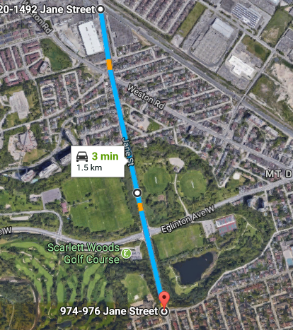

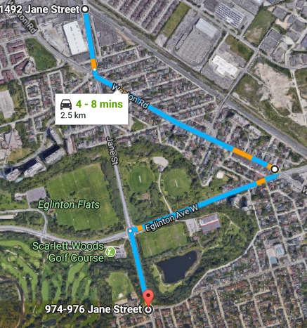

So according to google maps, we would be looking at ~5 minute detour, which is a bit much. I hate dogs' legs and milk runs in transit; buses are normally slow enough as it is.
It's also 1 km between Jane and the rail corridor.
So it's fair to put Jane back on the list of essential stops.

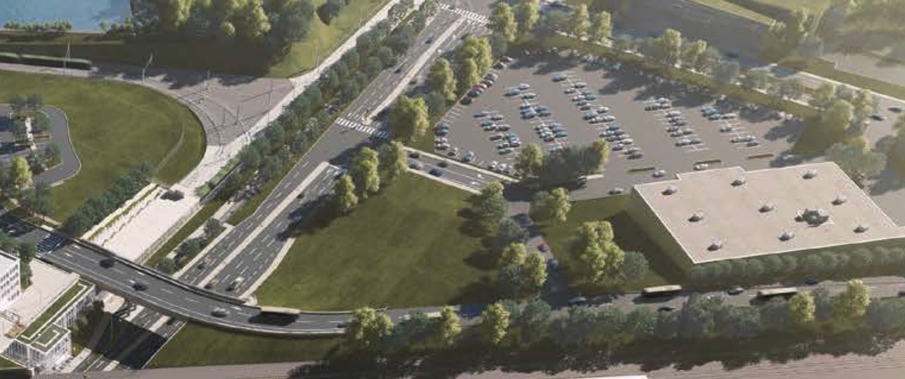

From the latest report (see link), I looked closely at the roadways. I asked them at the meeting that it looks like the buses will use the road leading to Eglinton Avenue as an exit only (judging by the lane arrows). They say, "Yes", that the buses may have to use Black Creek Drive and Photography Drive as an entrance because the other road is too narrow for two way bus traffic. That road would only be used by the buses to egress to Eglinton Avenue West.
This could mean a big increase in travel time for buses to enter the Mt. Dennis Station bus terminal. It will not be 5+ minutes for the Jane buses, but more like 8+ minutes. Judging by the traffic jams currently on Black Creek Drive, it'll be more like 10+ minutes.
They should consider widening that road from Eglinton, to reduce travel time for the buses.

Weston Rd is really bad in PM rush hour. Jane is already bad enough. Putting the two together makes it even worst. That section of Jane is really smooth and to remove that with a detour makes the route worst than it is already. They should definitely keep the Jane stop and build a bus terminal there. Keep the 35 split at Eglinton and run the 195 down to Bloor. This will fix up all the reliability problems south of Eglinton while running slightly less buses as ridership is lower. Even without a stop, there will still be delays from that intersection. The signal timing is just too difficult for them to give total transit priority without railway gate barriers.
IIRC it will not go via weston road, but via Eglinton both there and back. And it goes to the Photography Drive bus terminal, not the pedestrian entrance to Mount Dennis station at Weston Road.

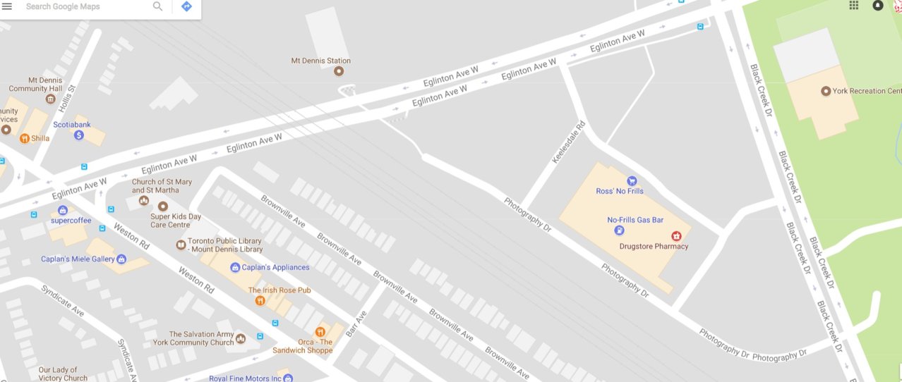

To get to Photography Drive, the buses will have to travel east to Black Creek Drive, turn right onto Black Creek Drive to get to Photography Drive, turning right to get to the bus terminal at Mount Dennis Station.
Exiting the bus terminal, the buses would travel south to the first street (Keelesdale Road), turning left they'll then turn left onto the former two-way street that would now be a one-way street north. There would be two lanes, one for right turns and one for left turns. Buses would be allowed to turn left to go westbound on Eglinton on a new traffic light, other motorists (non-transit) would only allowed turn right or eastbound.
mt-dennis-jpg.124419
Unless they widen Keelesdale Road for an extra lane for the buses to enter, keeping it as a two-way street. Hopefully, they will widen it.
