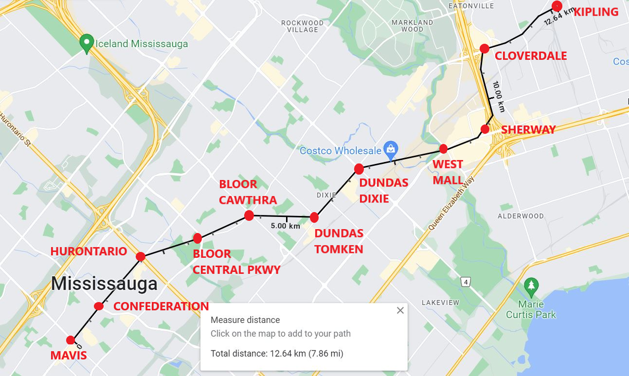

How about a route like this?
Disclaimer - This is rough drawing and I haven't planned for exact routes and turn radii, ridership potential, etc. This is just an idea.
It's a 12+ km route with 10 stations (maybe West Mall station can be skipped). I have deliberately chosen a diagonal route so that this route doesn't just cross all major north-south roads but also major east-west roads such as Bloor, Dundas and Queensway. That way it will intercept multiple north-south and east-west bus routes. The areas around the stations alone won't be enough to generate demand.
It may seem like the line is going under the houses all the way but it's only going under houses between Bloor-Cawthra and Dundas-Tomken. At other diagonal routes, it's either going under parks or industrial/commercial areas.
Can subway go under houses? I believe so because they are already doing that with Yonge Line in York Region. Once we see how Metrolinx is able to tunnel under those houses, we'll know if Metrolinx can replicate that here. The route can be planned in a way that ventilation shafts or emergency exits are somewhere on the internal streets instead of someone's backyards. They may still need to buy some people's front yards.
I have added a station at Confederation which some people may feel unnecessary. Burhamthorpe and Confederation is the centre of the density at MCC (not Square One itself). Mavis and Hurontario stations are 2 km apart so having a station in between a dense area is not superfluous. Right now there isn't that much density at Mavis but MCC is expanding west and that station will be become necessary in 20 years when this line could be built.
I am sure there would be many loopholes with this route and I would like to hear everyone's thoughts.
My pet idea is a fast connection between Square One and Toronto. So that not only Mississauga residents can commute to jobs in Toronto, but Toronto residents can commute to jobs near Square One.
For that purpose, maybe I would reduce the count of stations between Kipling and Square One. Retaining just Cloverdale, Dixie, Cawthra. That would result in less convenient connections with Mississauga bus routes, but a faster trip to Square One that could attract more riders.
No opinion on the Confederation and Mavis stations. If the density is (or will be) there, then sure.

I think you are missing the point that I am trying to convey. I said in my disclaimer that I am not considering ridership potential. This is just a possible option "if Metrolinx decides to extend subway to MCC with or without considering ridership".
Don't worry, I am not Doug Ford or Phil Verster. I won't be blowing away your taxpayer money on something like that. Take my suggested route with a bucket of salt.

A Line 2 extension to Square One would be a rather poor way to connect Square One to Toronto Downtown. Too many stops, and then have to transfer at St George. However, such an extension would be useful for a number of trips from Toronto Midtown to the Square One jobs. Say, someone lives near an N-S bus route not too far from Bloor, and can take a short bus trip and then the subway to a Square One office.
