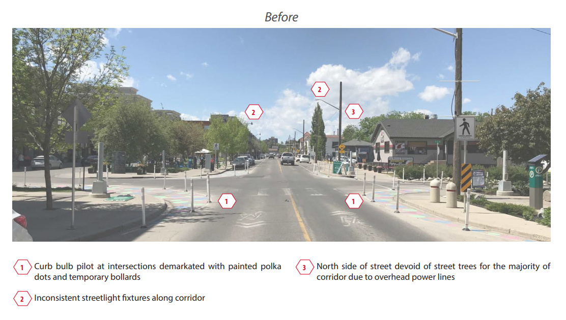

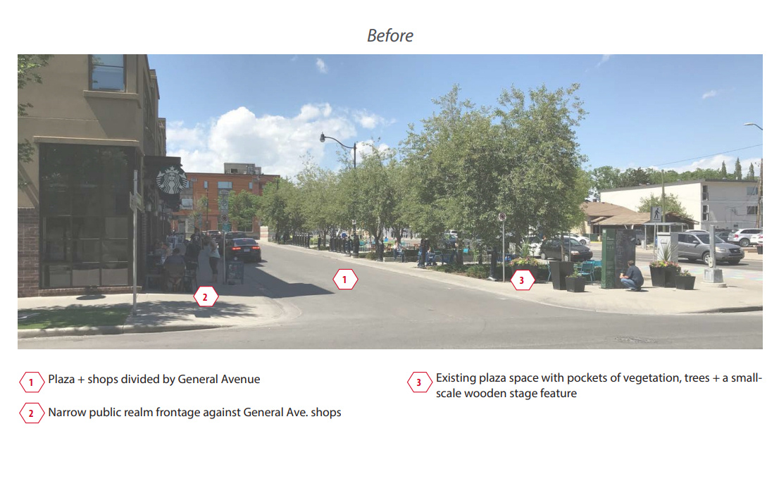

A few images fro the city's main street program in Bridgeland

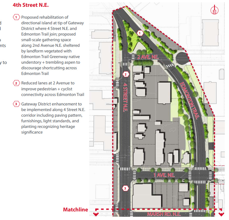

The Gateway project

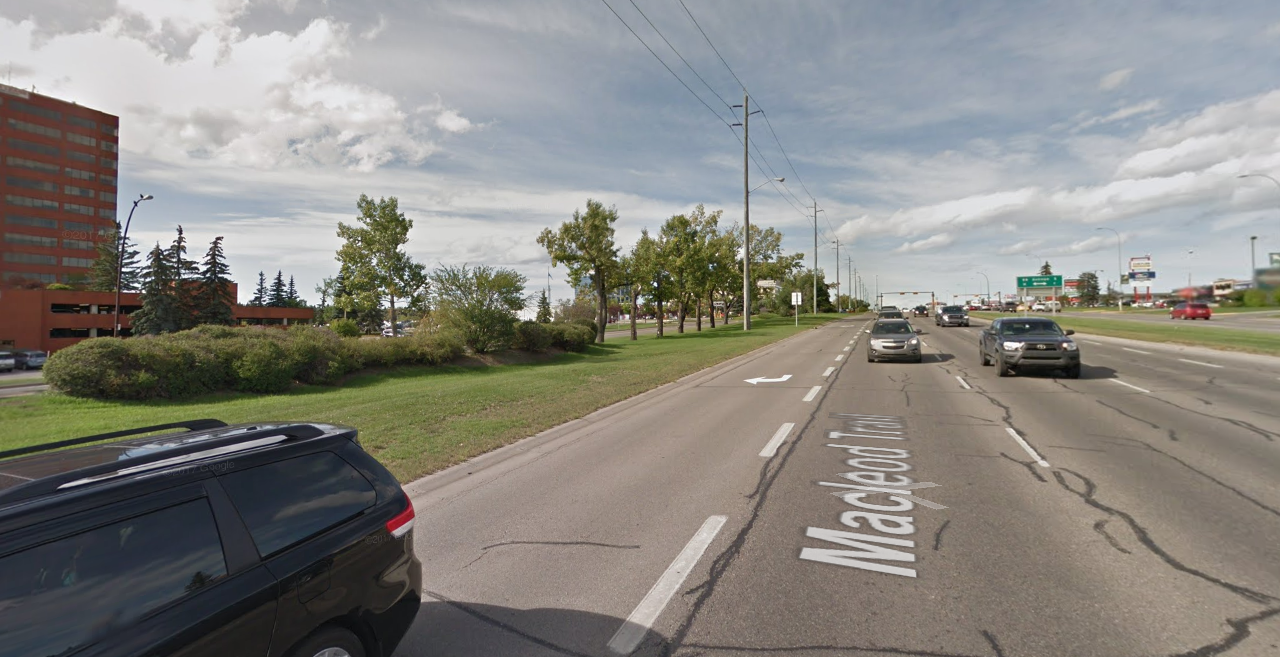

I looked up the city's priorities for Main Streets... Biggest takeaway for me was seeing Macleod Trail not being a priority. Isn't that the south's 'Main Street'? Not to mention that its a massive project, stretching 11 Kilometers from Willow Park Drive to the Bow River. You'd think you would want to get started on at least the portion from Glenmore to 17th Ave? A proper 'Main Street' could really draw some development to that corridor to really give it some life. The other parts, I agree with the city are not that important.
Macleod just seems like it's on such a different scale than all the others and would require so much more investment to move the needle even a tiny bit. I wonder if they are also waiting for Green Line and Deerfoot upgrades to be done before trying to tackle Macleod?

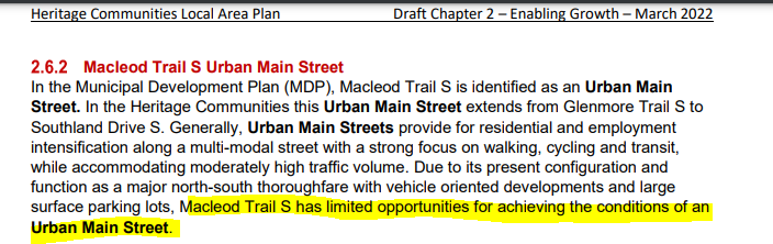

Macleod is and will never function as a 'Main Street', they have no intention to change the condition of the Stroad in any meaningful way. In my opinion the Main Streets that should've been selected in the south are Elbow Drive, Fairmount Drive for sure as the blocks are correctly oriented and possibly could work for Heritage Drive and Southland Drive. I imagine they picked Macleod to not piss off existing residents and because commercial is already located there, but this city does not do road diets and Macleod would need to be put on a enormous one to even resemble a ROW that could even pretend to be a Main Street.
They straight up say it won't resemble a Main Street in any new draft LAPs:
LAPs and more ambitious Main Street policies outside of the inner city seem like they will be documents of unending political compromise that will not change the status quo and will fold on good urban design.
Agreed that we should focus on lower hanging fruit, but there are ways of designing a street to both accommodate high volumes of traffic and also facilitate urbanity. Macleod between Chinook and downtown could be something much better than it is right now.

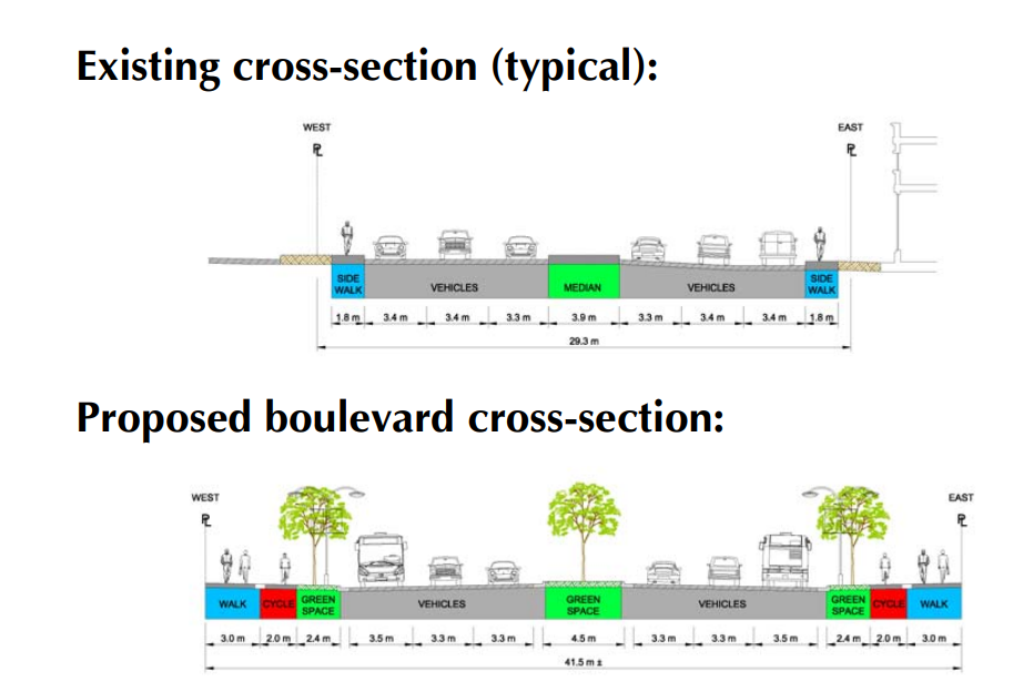

Macleod Trail was looked at about a decade ago, through a corridor study, to create a better cross-section to make it more of a pedestrian street, matching the recently minted "Urban Boulevard" status from the then only 3 year old MDP/CTP. The study ran from Anderson Road to 25th Ave SE, with Council approving the design from Anderson to 58th Avenue, but sending back the design from 58th to 25th. If I recall, the reason was that to build what was envisioned north of 58th Ave, it would cost about $100 million. Council was not on board with a project of that cost, that was ultimately a "street beautification" project, which still required acquisition of properties for an expanded ROW to fit the proposed cross-section. The proposed design can be found on the project link here:
Some examples:
50th to 58th Avenue South:
34th to 42nd Avenue South:
When you look at the presentation, everything south of 58th Avenue was approved, as it didn't really involve a lot of work to implement. No moving of the ROW boundaries and a slight adjustment to curb lines to narrow lanes. So, relatively easy to implement. As an example, here is what was proposed (and approved) for the stretch between Southland Drive and 109th Avenue South:

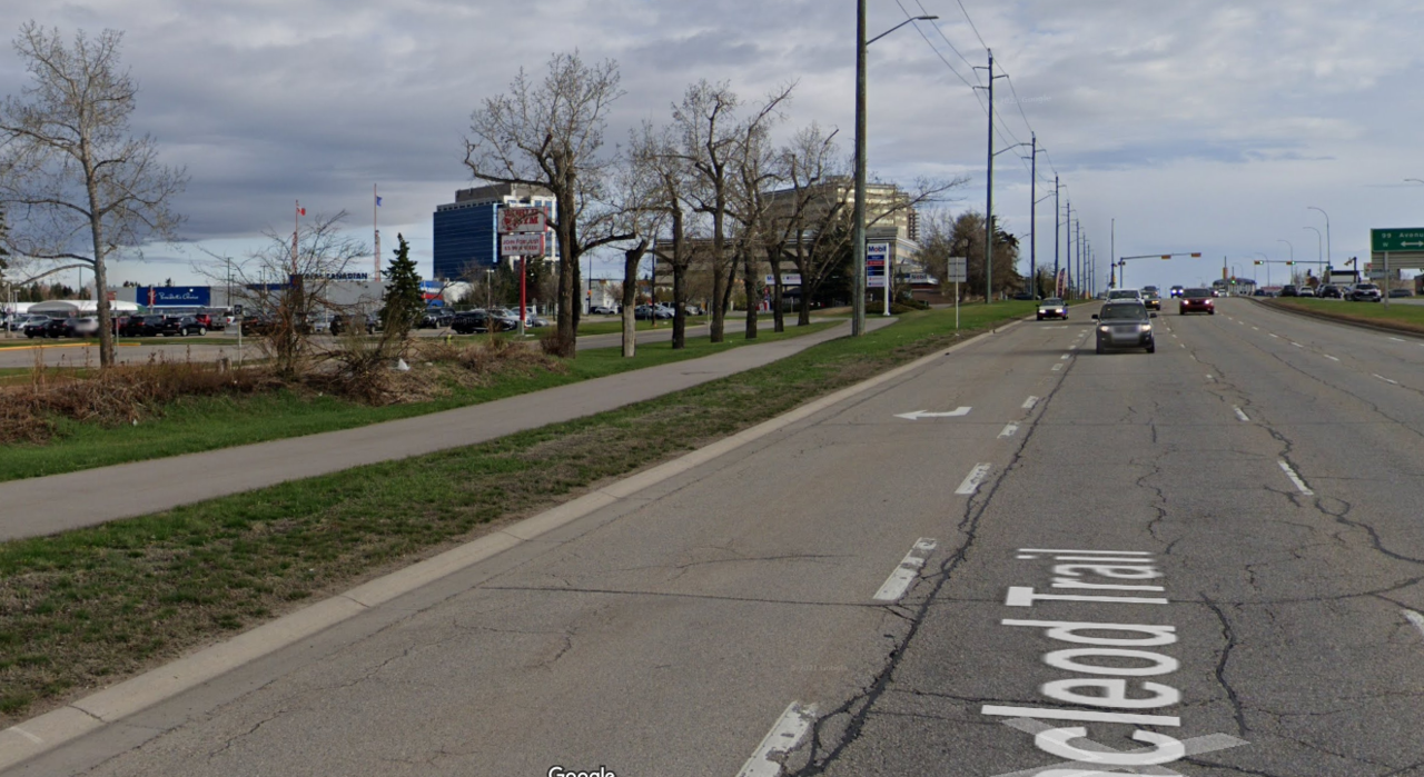

The City actually did some work on this stretch, around 2016 when looking at historical air photos and the Streetview Time Machine. For example, here is the west side of Macleod Trail in August 2015, looking pretty unfriendly for pedestrians, much like the existing condition in the cross-section above:
And, here it is, post improvement/investment as shown in May 2021:
That kind of matches the approved cross-section, right? Oh wait, there isn't a 5.0m sidewalk, or seperate cycle track, or even boulevard trees acting as a buffer..... It is better than what was there before (pretty low bar), but why bother meeting an approved plan, when you can spend a fraction of the amount and put up something inferior?
Unfortunately I feel like this is another example of proving that approved plans/policy in this city mean Jack Sh!t......Or maybe I am just being cynical this morning.
