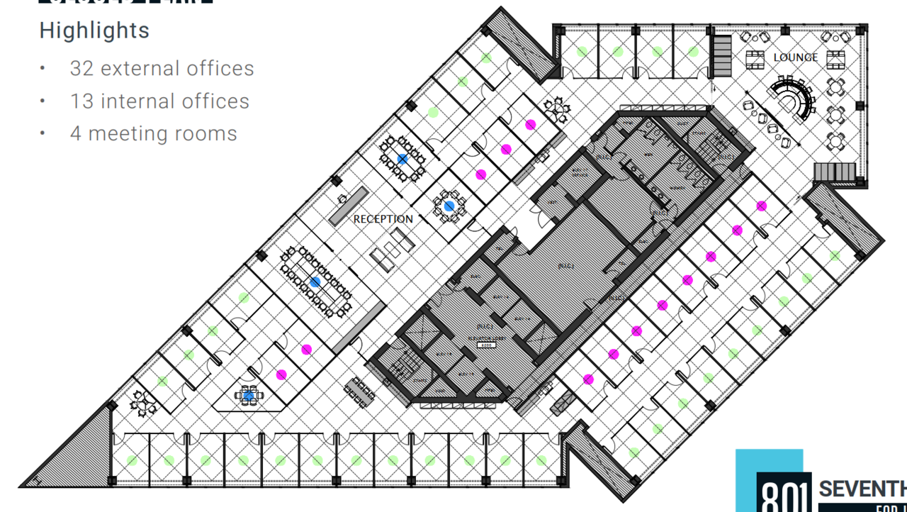

Nexen Tower has some pretty big floor plates that are a weird shape, I think it would be very challenging residential conversion. Although it would be cool if it happened, just doesn't seem like an efficient floorplate for apartments.
I have always thought a number of building around Nexen Tower seem like they could be suitable candidates for residential conversion: Century Park Place, 815 8th Ave SW, Taylor building (805 8th Ave SW), Petro Fina, Elveden Centre, Northland Building and Dominion Centre. Would be cool to get primarily residential buildings fronting or very near Century Gardens.
The weird shape could be a benefit for it. 17,000 square feet. Steel structure concrete core. Inset balconies anyone? They have to do a lot of work anyways remediating.
Here's a typical floor plate for Nexen:
Look at all of that unusable space -- everything in grey!
The grid is a 5 foot grid. The two main chunks of floorspace in the upper left and lower right (reception and the facing offices) are 40 feet from the core to the windows; that's 10 to 15 feet more than is usable. The narrow parts on thé top and bottom are 25 feet, which is alright. The upper right corner where the lounge is, that could be a very cool two-bedroom. The lower left is just super awkward. You'd have to do inset balconies to make the bulk of the floorspace usable; that's the only way.
Unfortunately, inset balconies would rob the building of a lot of it's grace.
